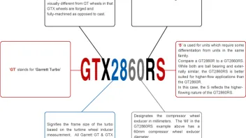

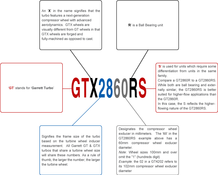

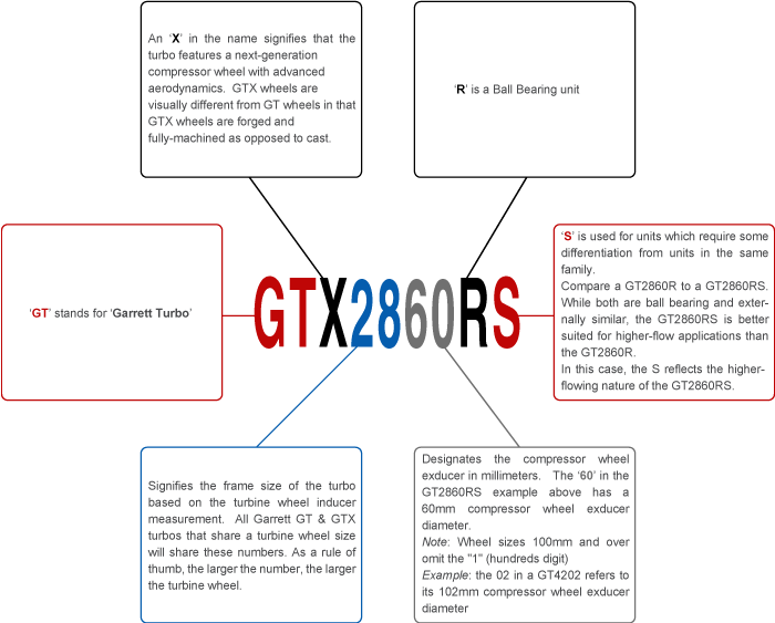

    Official web turbobygarrett.com:
    If there's an "R" on the end of a model name, this means the unit is ball bearing. So, a GT4294 is not ball bearing; whereas a GT4294R is ball bearing.
    GT
    The GT designation refers to Garrett's state-of-the-art turbocharger line. GT-series turbos use redesigned bearing systems and modern compressor/turbine aerodynamics. These new compressor and turbine wheels represent huge efficiency improvements over the old T2, T3, T3/T4, T04 products. The net result is increased durability, higher boost, and more engine power over the older T-series product line.
